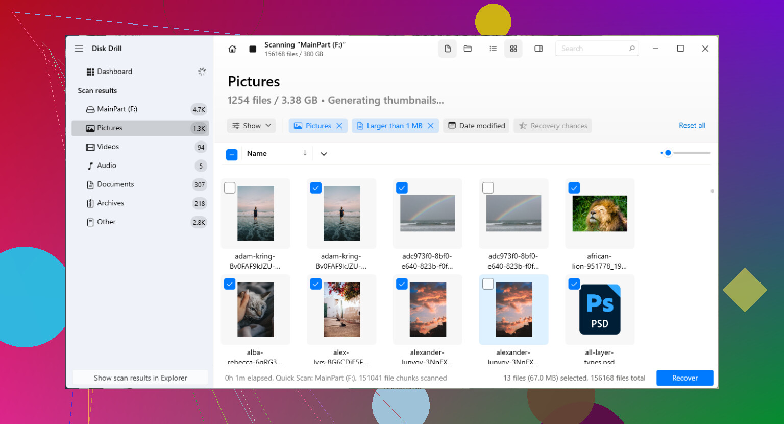

For DIY recovery, use recovery software before trying file system repairs. Disk Drill is one option that can scan Seagate external drives for lost partitions, damaged file systems, deleted files, and issues caused by unplugging the drive without safely ejecting it.

  • Scan the drive or the image. When results appear, preview the files before recovering them. If a file previews correctly, that’s usually a good sign.
  • Recover the files to a different storage device. Do not save recovered files back onto the same Seagate drive during recovery.
