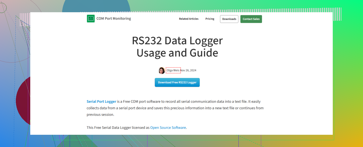

If you want a more complete RS232 data logger guide with examples, config tips, and screenshots, this page is good:
practical RS232 data logging guide
It walks through setting baud rate, parity, log format, and how to structure CSV output so you can feed it straight into Excel or Python.
